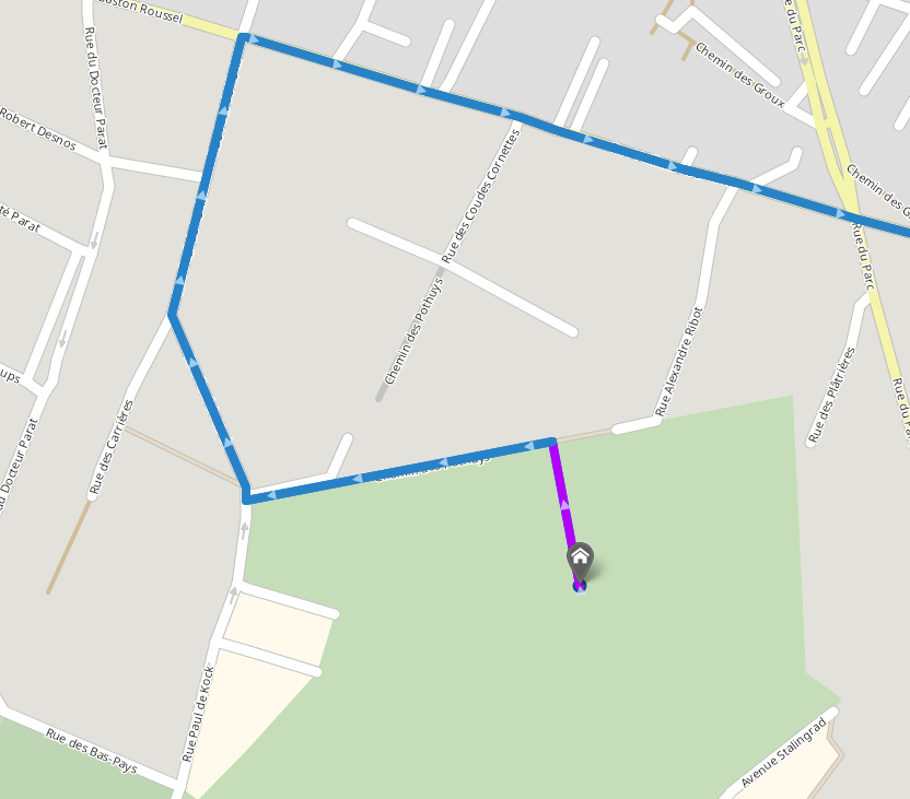

OffRoadWaypoint
Visualisation of an OffRoadWaypoint
The distance and traveltime from this waypoint to the road network is estimated and included in the response. For each OffRoadWaypoints, there is a corresponding waypoint in the response.

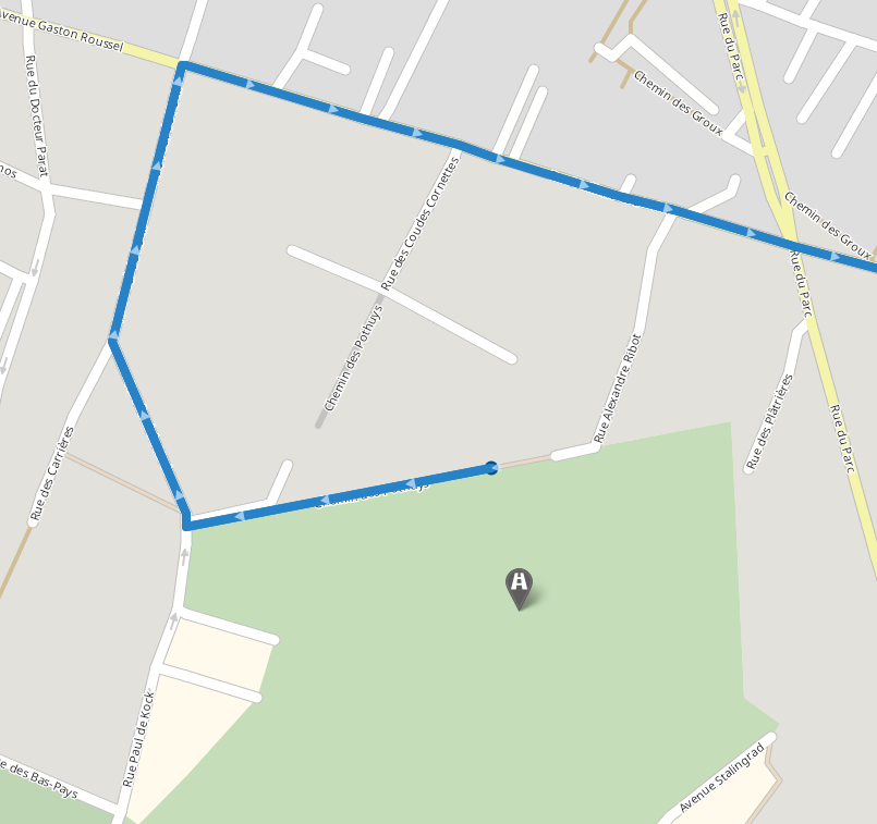

OnRoadWaypoint
Visualisation of an OnRoadWaypoint
Each OnRoadWaypoint add a corresponding waypoint in the response. Each corresponding OnRoadWaypoint is directly placed on the road network.

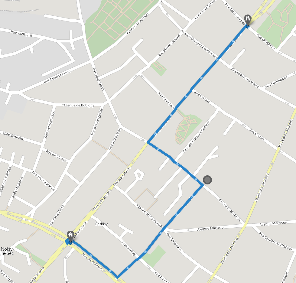

ManipulateRouteWaypoint
Visualisation of a ManipulateRouteWaypoint
The route passes near the specified waypoint coordinate specified in the manipulateRouteWaypoint. A manipulateRouteWaypoint does not add a corresponding waypoint in the response. Moreover, it can't be neither the start or the end of a route, only a via waypoint.

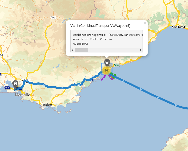

CombinedTransportWaypoint
Visualisation of a CombinedTransportWaypoint
The route takes the specified combined transportClosed id. A combinedTransportWaypoint does not add a corresponding waypoint in the response. Moreover, it can't be neither the start or the end of a route, only a via waypoint.
